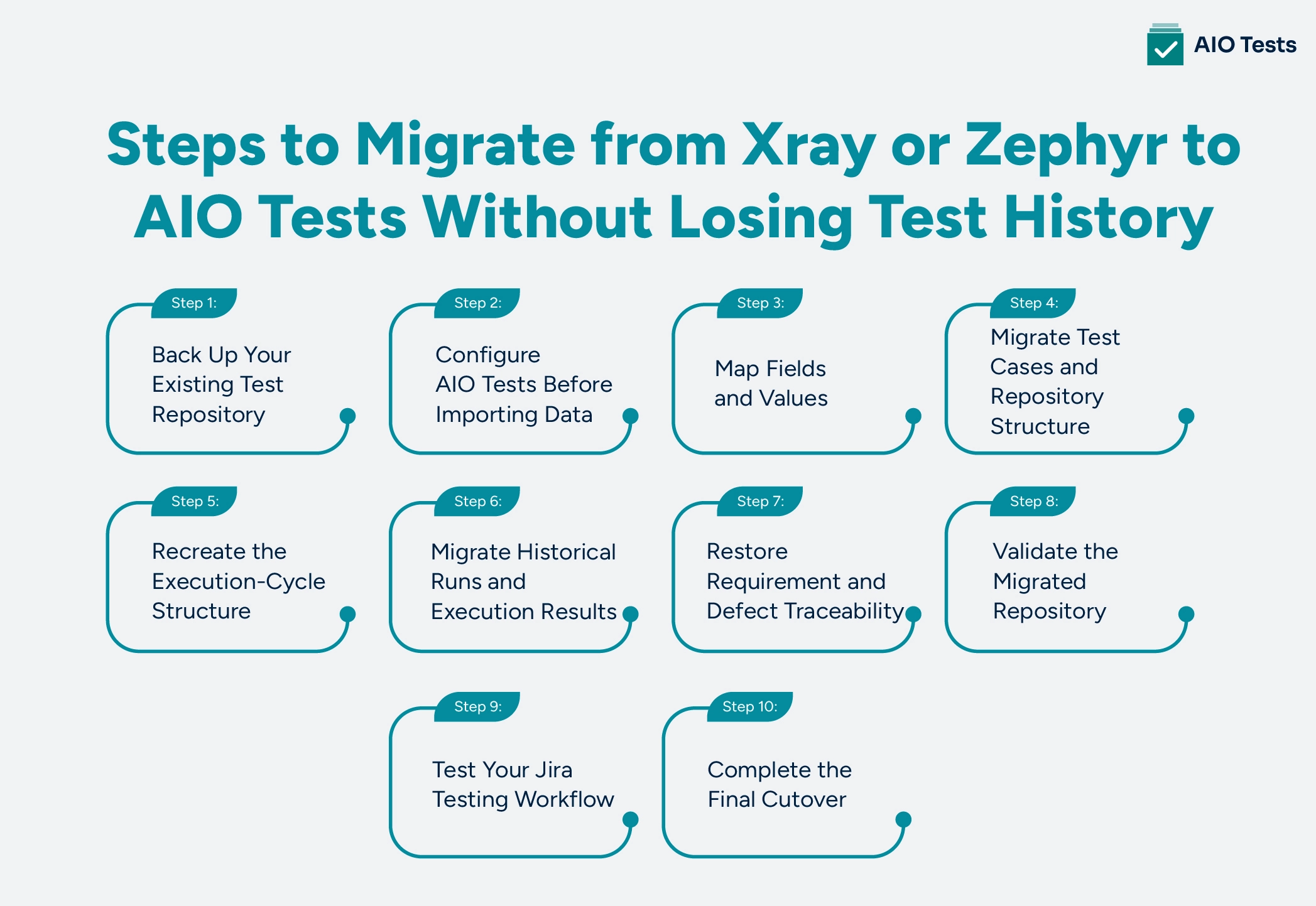

Infographic showing 10 steps for Jira test management migration from Xray or Zephyr to AIO Tests, from repository backup and data mapping to validation and final cutover.
Step 1: Back Up Your Existing Test Repository
Before starting the test case migration, create a complete backup of the Xray or Zephyr repository. This gives you a recovery point and a reliable source for checking whether important data was transferred correctly.
Capture:
  • Test case exports
  • Folder and repository structure
  • Historical execution records
  • Attachments
  • Requirement associations
  • Defect links
  • Custom-field definitions
  • User references
Keep the original system accessible until migration validation is complete. If cases, executions, or relationships are missing in the Jira test management tool, the source repository can be used for comparison and recovery.
The backup also supports final reconciliation, allowing teams to compare source and destination records before making the test management platform the active system of record.
Step 2: Configure the AIO Tests Project Before Importing Cases
Set up the destination before moving data. Review and configure:
  • Case statuses and priorities
  • Case types
  • Custom fields
  • Folder structure
  • Permissions
  • Relevant Jira project settings
Custom fields must exist in the platform before import, since only existing fields appear in the mapping screen. Statuses, types, and priorities work differently. Matching names are assigned automatically, so creating them upfront removes most of the mapping work.
Step 3: Create the Field and Value Mapping
The import runs three mapping stages. Field mapping matches your columns to AIO fields, data mapping matches the values inside them, and user mapping matches people across the two systems.
Review fields such as:
  • Status
  • Priority
  • Case type
  • Custom fields
  • Folder
  • Requirement reference
  • User
For example, source priority values such as Highest, High, Medium, and Low may need to map to the platform values such as Critical, High, Medium, Low, and Lowest.
Document these mappings before import so the same rules are applied consistently across the repository.
Step 4: Migrate Test Cases and Repository Structure
Once the mapping is ready, begin the test repository migration.
Focus on preserving:
  • Test titles and descriptions
  • Steps and expected results
  • Folder hierarchy
  • Statuses, priorities, and types
  • Supported custom fields
  • Requirement mappings
  • Classic or BDD/Gherkin cases
The platform supports Excel, CSV, and BDD imports, along with migration options for Xray and Zephyr.
Preserve Source IDs
When using Excel or CSV, retain existing case identifiers where possible. They make it easier to compare migrated records with the source during validation.
Preserve Folder Hierarchy
Map folder paths carefully so cases do not end up in a flat or incorrectly organized repository.
Map Jira Requirements
Include requirement references during import where supported so traceability does not have to be rebuilt manually afterward.
Check Custom-Field Limitations
Not every custom-field type is handled the same way. For example, user-type custom fields are not imported through the standard Excel/CSV method and may need separate handling.
Step 5: Recreate or Map the Execution-Cycle Structure
Migrating cases alone does not preserve the context in which they were executed.
Recreate the cycles needed to organize historical runs, such as:
  • Release testing cycles
  • Regression cycles
  • Sprint-based testing
  • Environment-specific cycles
The Jira test management tool uses Cycles to organize execution activity and allows Cases and Sets to be included within those cycles.
The goal is to give historical execution results the correct context rather than placing old runs into unrelated or newly created structures.
Step 6: Migrate Historical Runs and Execution Results
This is one of the most important parts of preserving test history.
The test management platform provides APIs for migrating execution data, including support for backdated runs. This helps preserve the original execution chronology instead of making historical tests appear as though they were run on the migration date.
  • Runs, statuses, dates, defect links and comments move through the Migration endpoints.
  • Evidence and attachments do not. They upload through separate endpoints once the runs exist, so plan them as a second pass.
Confirm which fields are supported by the chosen Xray or Zephyr migration method before assuming every historical attachment, comment, user assignment, or audit event will transfer automatically.
Step 7: Preserve or Restore Jira Requirement and Defect Traceability
After the test asset migration, verify that the relationships around each test still make sense.
The intended flow should remain clear:
Requirement → Test Case → Execution → Defect
  • Use the Traceability Detail report to check these in one view.
  • It shows requirements, linked cases, execution results and defects as four columns, which is the same chain you are trying to verify.
  • For coverage totals, the Traceability Summary report accepts JQL so you can reconcile against the same requirement set you queried in the source tool.
Where requirement mappings are included during Excel or CSV import, they can be carried into the test management platform along with the migrated cases.
Maintaining these relationships is essential for coverage reporting, defect analysis, and release-readiness reviews.
Step 8: Validate the Migrated Repository Before Cutover
Do not assume that a successful import means the migration is complete. Reconcile the source and destination before retiring Xray or Zephyr.
Compare:
  • Test-case counts
  • Folder structures
  • Cycles
  • Historical runs
  • Execution-status distribution
  • Defect relationships
  • Attachments where applicable
  • Custom fields
Run Record-Level Validation
Select representative records and follow them end to end:
Requirement → Case → Cycle → Run → Result → Defect
This catches mapping errors that total record counts alone may miss.
Step 9: Validate Your Jira Testing Workflow Before Retiring the Old Tool
Use a short validation period to confirm that the migrated repository works in day-to-day testing.
Verify:
  • Test creation
  • Manual execution
  • Automated-result reporting
  • Requirement traceability
  • Defect logging
  • Permissions
  • Reports
  • QA team workflows
The objective is not to run two tools indefinitely. It is to identify missing data, broken relationships, or workflow issues before the source system is switched off.
Step 10: Complete the Final Cutover
Once the migrated data and workflows have been validated, complete the cutover in a controlled way.
  • Stop creating new test assets in Xray or Zephyr.
  • Capture changes made after the initial migration.
  • Move any remaining records using the supported migration method.
  • Run a final reconciliation.
  • Preserve source exports where required.
  • Update QA documentation and internal processes.
Treat this as part of the overall Jira migration strategy, not as an automatic “delta migration” feature unless that capability has been specifically confirmed for your migration setup.
