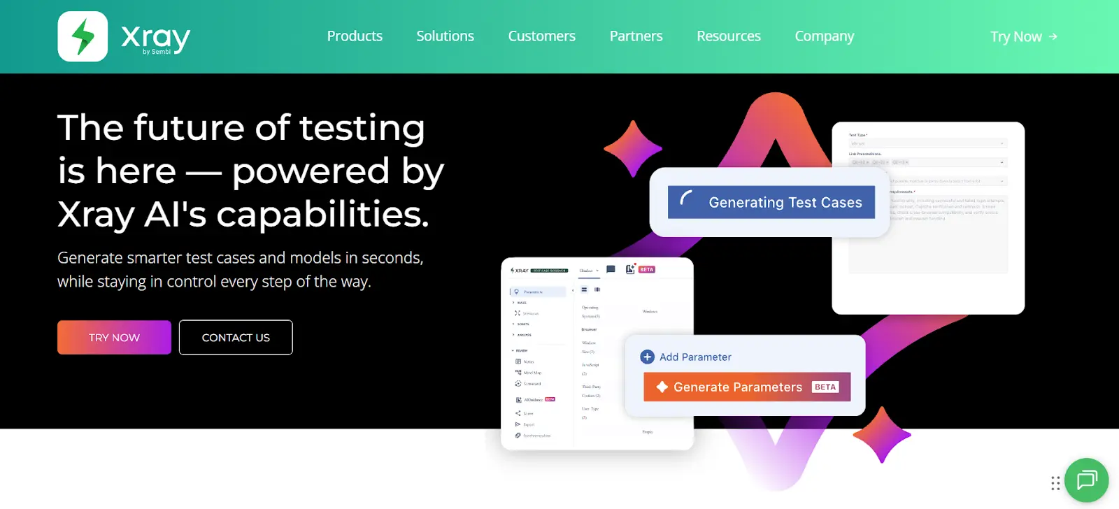

Xray does a lot well: tests as Jira work items you can search with JQL, a Test Repository with folders, reusable preconditions, BDD, custom fields on individual test steps, and AI test case generation in its Standard edition. Teams rarely leave because something basic is missing; they leave because of friction that shows up every week. Here’s how the usual reasons sort out:

You want AI to draft test casesNo. Xray Standard includes AI test case generationNot a reason to switch on its own

Is AI a good reason to leave Xray?
No. Xray’s Standard edition includes AI test case generation. Compare tools on set-up, automation, reports, bugs and your migration instead.
