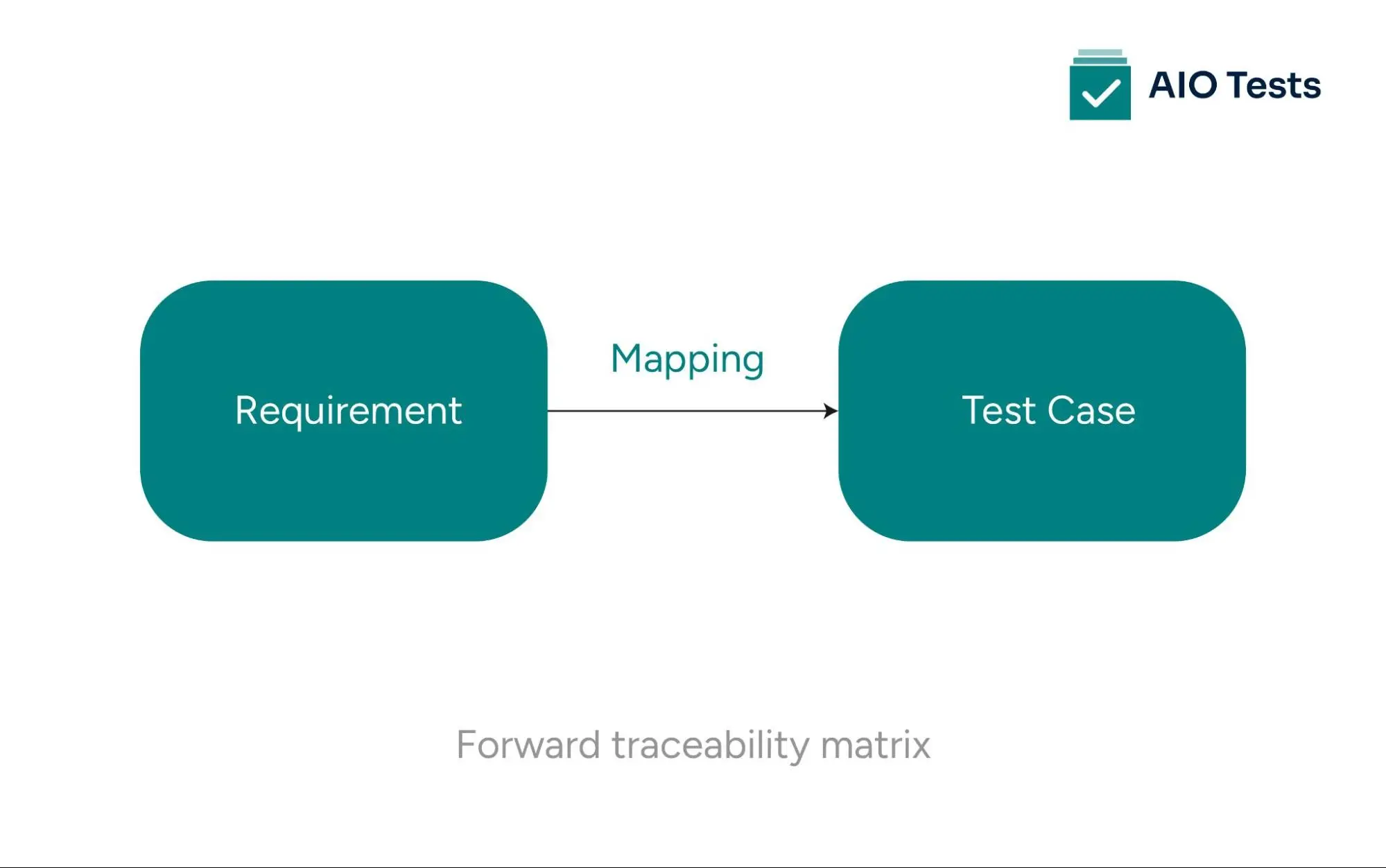

1. Forward Traceability
This tracks each requirement as it moves forward into design, development, and testing. It helps ensure that nothing requested by the client or product owner is missed during implementation.
For example, if a requirement specifies a login feature, forward traceability shows all the test cases built to verify it works under different conditions.
Forward traceability matrix

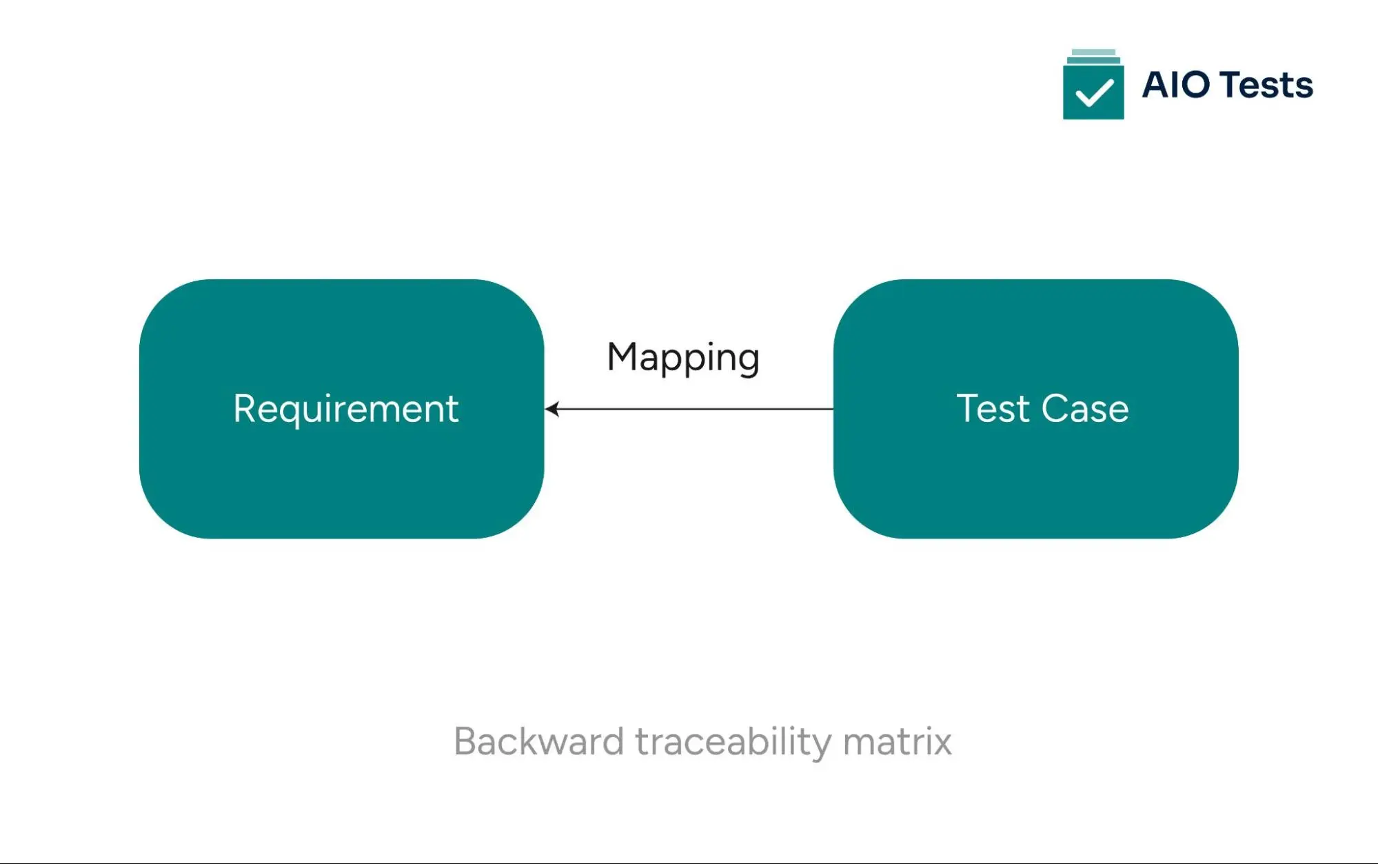

2. Backward Traceability
This process works in reverse: from test cases or defects back to the original requirements. It ensures that every test exists for a reason tied to business value.
If you see a test in your suite, backwards traceability tells you why it’s there and what it’s validating. This is especially useful during scope reviews or test cleanup.
Backward traceability matrix

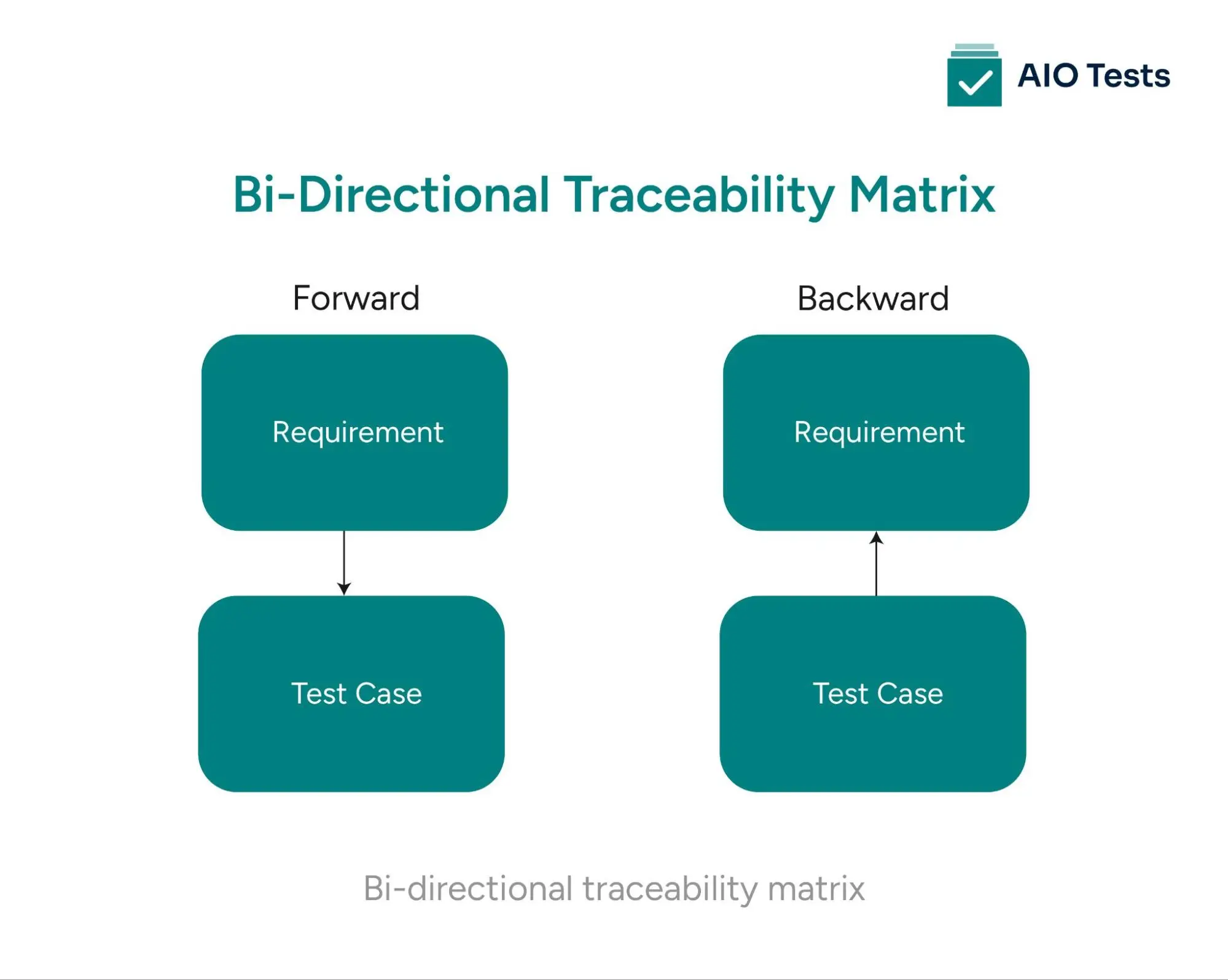

3. Bidirectional Traceability
This combines both directions. It allows teams to trace:
  • From any requirement → what test cases validate it.
  • From any test case → what requirement does it cover?
Bidirectional traceability gives full visibility across the project by strengthening the requirement to test case mapping in RTM, ensuring no gaps between business needs and testing.
It’s the most thorough approach and the most valuable when dealing with large systems, regulated environments, or when changes happen late in the development cycle.
Bi-directional traceability matrix

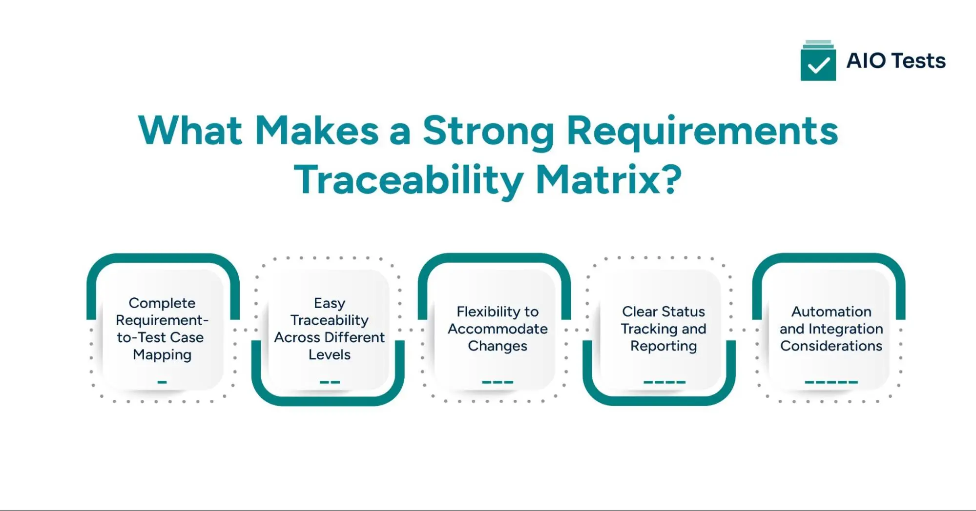

What Should You Look for When Creating a Requirements Traceability Matrix?
A requirements traceability matrix (RTM) is only as good as the way it’s structured and maintained. Simply having a table that links requirements to tests is not enough.
To get real value, you need to follow clear criteria that ensure your RTM is practical, accurate, and actionable throughout the software testing lifecycle. Here’s what to focus on when creating and managing an RTM:
 Factors to look for in the requirements traceability matrix
1.Complete Requirement-to-Test Case Mapping
The core function of an RTM is to connect every requirement to a test case. Without this mapping, traceability is incomplete.
  • All Requirements Covered: Ensure every functional and non-functional requirement has at least one associated test case.
  • Clear Links: Each test case should explicitly reference the requirement it verifies. Avoid vague references like “related requirement.”
  • Prioritization: Tag requirements by priority, high, medium, and low, so you can see which critical requirements require more rigorous testing. This also helps in risk management during regression testing.
2.Easy Traceability Across Different Levels
Requirements exist at multiple levels: business, functional, and technical. Your RTM should account for all of these to provide a comprehensive overview.
  • Hierarchical Traceability: Map high-level business requirements to functional requirements, and then to specific test cases.
  • End-to-End Visibility: A robust RTM should allow stakeholders to trace a single requirement from its origin to the test results, offering a full lifecycle view.
  • Linking Defects: Ideally, the RTM should also tie in defects back to the test cases and requirements. This allows your team to quickly assess which requirements are failing and why.
3.Flexibility to Accommodate Changes
Requirements are rarely static. They evolve as business needs change or new insights emerge during development. A good RTM should be flexible enough to reflect updates without becoming obsolete.
  • Version Control: Track changes to requirements and test cases over time. This ensures historical context is preserved.
  • Impact Analysis: When a requirement changes, the RTM should quickly show which test cases are affected. This saves time and prevents gaps during regression testing.
  • Ease of Updates: Maintaining an RTM should be straightforward. Complicated, hard-to-update spreadsheets often lead to outdated or inaccurate traceability.
4.Clear Status Tracking and Reporting
An RTM is not just a static document; it’s a tool for ongoing monitoring and decision-making.
  • Pass/Fail Status: Each test case should have an easily trackable status to show whether the requirement it covers has been successfully tested.
  • Progress Metrics: Use the RTM to monitor testing progress against requirements. You should be able to answer questions like “How many high-priority requirements are still untested?”
  • Stakeholder Communication: A well-structured RTM serves as a perfect source for developers, testers, and business stakeholders alike. Reports generated from the RTM provide transparency and support better decision-making.
5.Automation and Integration Considerations
While an RTM can start as a spreadsheet, large-scale projects benefit from automation and integration with QA testing tools.
  • Tool Integration: Integrate your RTM with test management and defect tracking systems to ensure real-time updates and accurate traceability.
  • Automated Updates: Some modern automation testing software allows automatic linking of requirements, test cases, and defects. This reduces manual errors and ensures your RTM always reflects the current project state.
  • Data Consistency: Automation helps maintain consistency across multiple test cycles, especially during regression testing and iterative development.
