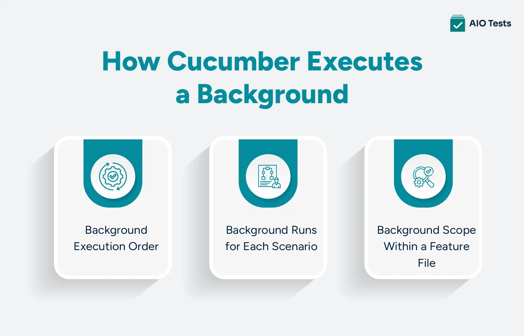

How Cucumber Executes a Background
Understanding how a Cucumber Background executes helps teams structure setup correctly and avoid treating it as a one-time initialization block.
 infographic image showing How Cucumber Executes a Background
Background Execution Order
For a typical Cucumber scenario, the execution flow is:
Before hooks → Background steps → Scenario steps → After hooks
A Before hook can handle technical setup, such as initializing a browser or test environment. The Background then establishes the shared business context before the scenario runs its own Given, When, and Then steps.
Background Runs for Each Scenario
The Background runs before each scenario in the feature. It is not executed once and then reused by subsequent scenarios.
If a feature contains three scenarios, the Background steps are executed as part of the setup for each of those three scenarios. This helps each scenario start with the expected shared context rather than depending on the state left behind by another scenario.
Background Scope Within a Feature File
A Background applies to scenarios within the feature where it is defined. It is useful for sharing readable business context across those scenarios, but it is not a global reusable setup mechanism.
If the same setup is needed across multiple feature files, do not treat the Background as a global block. Depending on what needs to be reused, the implementation may belong in step definitions, hooks, or another test-management mechanism.
This distinction is important when designing larger BDD test suites: Background provides shared feature-level context; it does not create globally reusable preconditions.

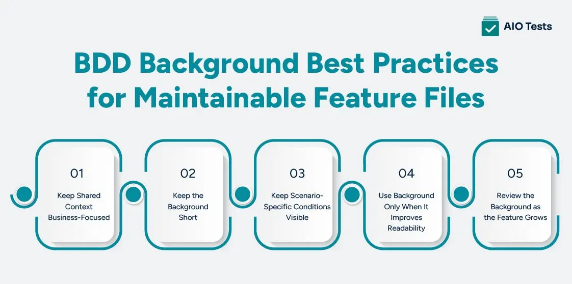

BDD Background Best Practices for Maintainable Feature Files
A good BDD Background should make a feature file easier to read, not just reduce the number of lines. These practices help keep shared context useful as features and test suites grow.
Use a BDD Background to make shared context easier to understand and maintain. These practices help keep it useful as your feature files grow.
infographic image showing BDD Background Best Practices for Maintainable Feature Files
Keep Shared Context Business-Focused
Write Background steps around business state that readers can understand. This keeps Gherkin in BDD focused on behavior and business context rather than technical implementation details.
Background:
  • Given I am logged in as an administrator
  • And I have permission to manage users
Avoid technical details such as browser setup or database configuration.
Keep the Background Short
Include only the conditions shared by most scenarios. A long chain of Given steps can make the feature harder to read.
If the setup becomes too large, move technical setup to hooks or consider splitting the feature.
Keep Scenario-Specific Conditions Visible
A Background should not hide conditions that help readers understand a scenario.
If a condition explains why a test passes or fails, keep it in the scenario even if it means some repetition.
Use Background Only When It Improves Readability
Do not move a Given step into the Background just because it is repeated.
Use it when removing the repetition makes the feature easier to understand without hiding important test context.
Review the Background as the Feature Grows
A Background that works for a small feature may become too broad as more scenarios are added.
Remove conditions that no longer apply to most scenarios, or split the feature when the scenarios no longer share a clear business context.
